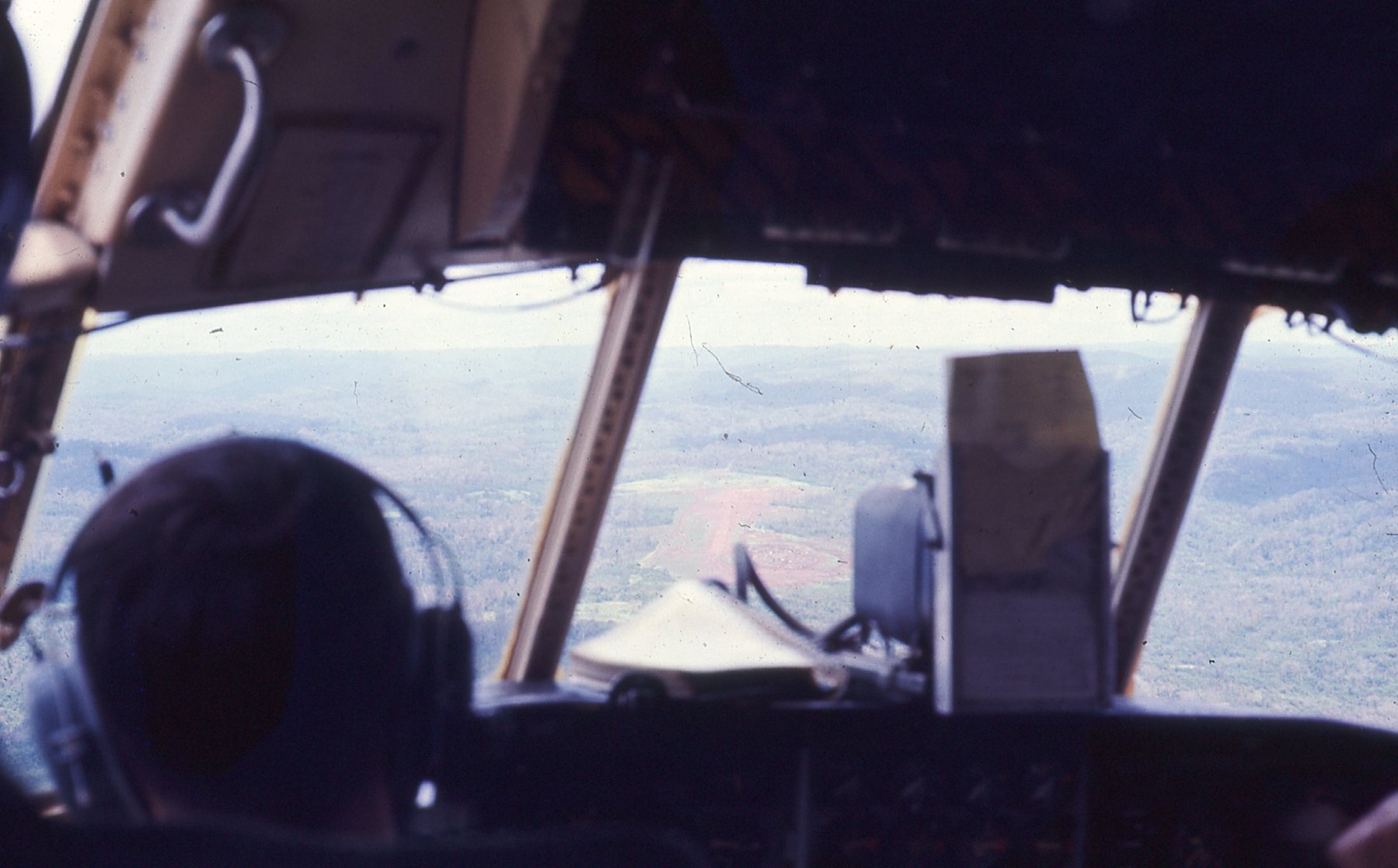

In Vietnam we operated at about 135000 lbs at forward fields. Usually we were heavier landing than taking off. Some times you would max out with rolling stock and be pretty heavy leaving as well. I know we climbed out at the steepest angle the we could based on our weight and airspeed. Approaches is a different story. I had a couple of A/Cs that would hold lots of altitude and pretty much dive down to the runway. Even operating pretty heavy it is still a very impressive aircraft. I crewed an "E" which at the time was the newest stuff we had. A few time we flew max gross weight around 155,000 lbs and takeoff roll was several thousand feet and there was no steep climb out...You can see in this picture we are still around 4,000' on short final to a short strip
