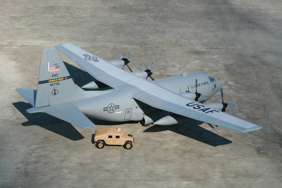

Sorry for the intrusion by a non flyer, but I am looking for online reference regarding the placement and configuration of the electroluminescent formation lights on a C-130H.  The info is for the purposes of detailing a 1/25 scale flying RC model.  I have included simulated lights for the fuselage and vertical stab since they are readily visible in most photos.  Photos that show the slime lights on the top and bottom of the wings, fuselage and horizontal stab are harder to find.

Photo attached is the model I am working on with a 1/25 scale Humvee for reference.

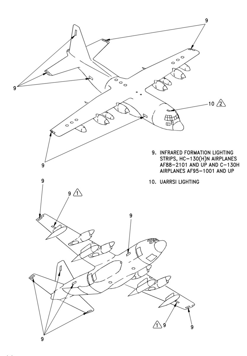

They are electroluminescent formation lights.
All items labeled 9 in attached picture.
Modified by TCTO or came with from factory on H-models.  Typically only guard/reserve units paid for TCTO
