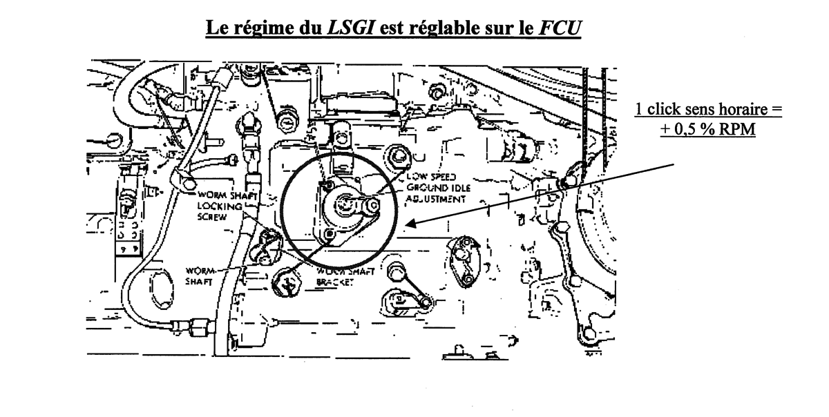

As you can see the Low Speed Ground Idle is Adjustable on the FCU.
If you have the RPM's very low, you must adjust them between 96.3 and 99.1 for High Speed Ground Idle.
When you adjust LSGI on FCU, it will increase the HSGI.
Regards!!
Regards!!
