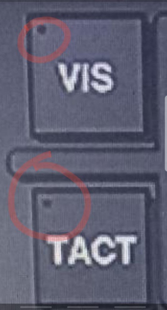

avio@superherc Posted May 20, 2019 Share Posted May 20, 2019 Is it possible to replace the tiny corner lights on a HUD Control panel? or replacing the whole panel is the only option? Refer the Figure. Quote Link to comment Share on other sites More sharing options...
hehe Posted May 21, 2019 Share Posted May 21, 2019 No. The bulbs/lenses are not stock listed or authorized to be repaired. What variant of J-model do you work on? I wrote procedures to R2 most flight deck control panel bulbs for the AHMC-130J 31JG manuals. But the HUD panel was not part of that for reasons above. Quote Link to comment Share on other sites More sharing options...
avio@superherc Posted May 27, 2019 Author Share Posted May 27, 2019 Thanks for responding. I am talking about c130J-30. Take the reference and mode selector panel, push the corner of the button and it snap open. We can easily replace the bulbs. Thought it would be the same for the HCP also. thanks Quote Link to comment Share on other sites More sharing options...
