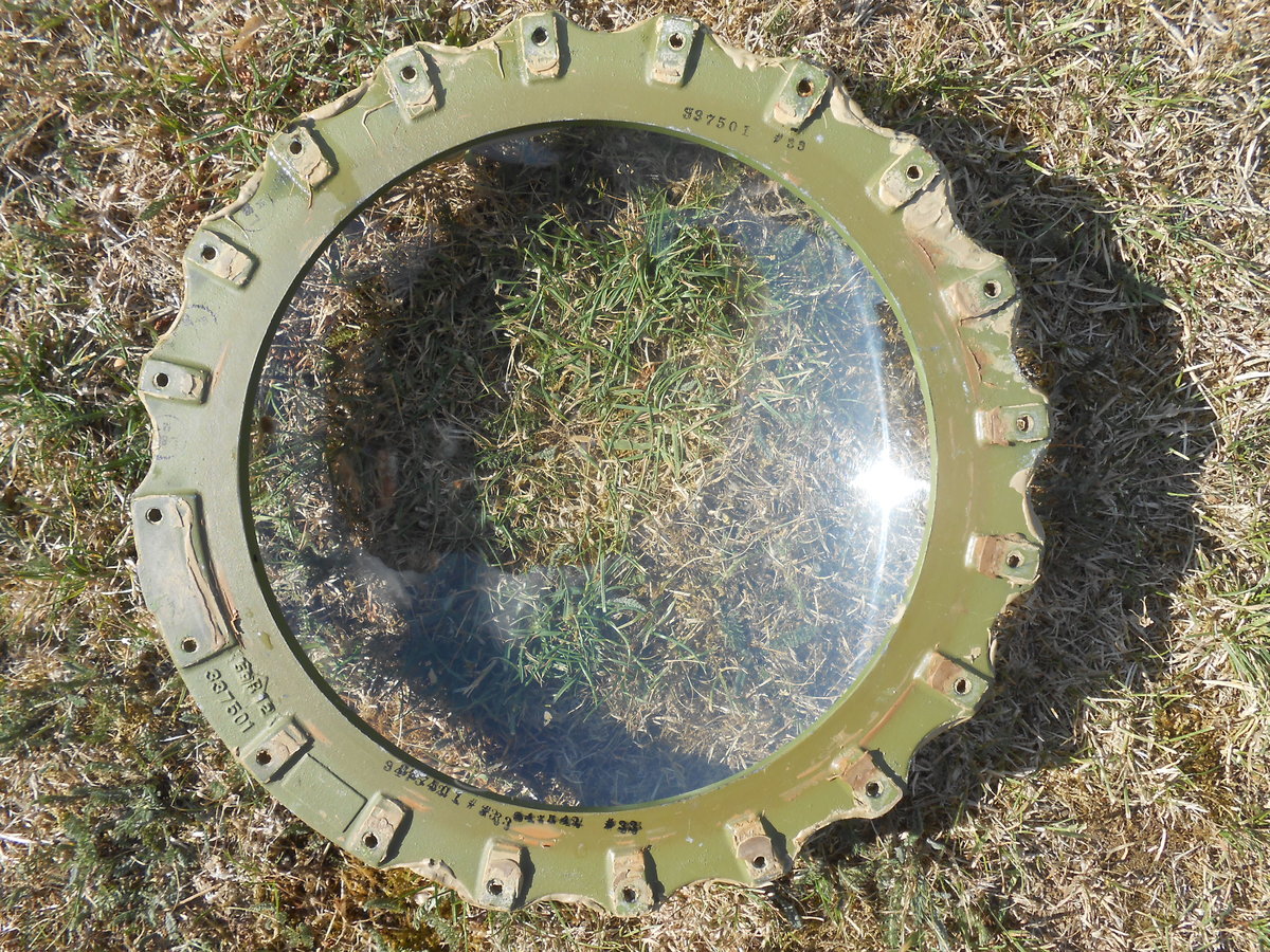

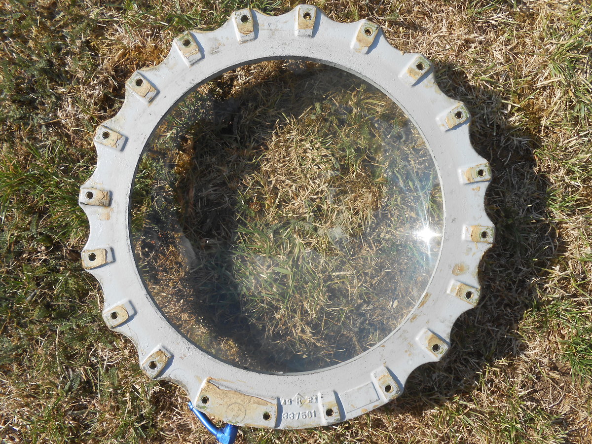

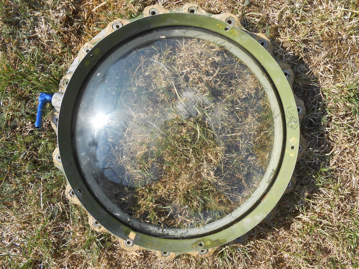

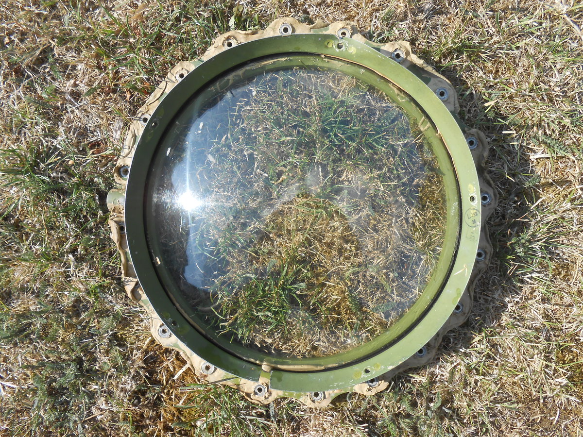

Hello everyone,
I need help with these two American airplane portholes. They come from the former NATO Evreux air base. As you know, at that time, on this air base, there were Fairchild C119 then Lockheed C130.
These two portholes are 34cm wide.

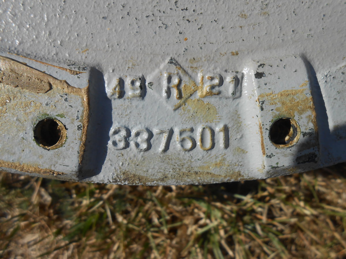

The markings found are: 59 R 12
                                                          337501
                                                           337592
Hoping you could help me?
Thank you so much.
Laurent
The Fairchild C-119 Flying Boxcar fuselage windows had 16 rivet holes (see link)
 http://www.schildhouse.com/aviation_files.html#fairchild_c119
Your photo clearly shows 20 holes. That said, both items were fabricated by Lockheed
PN: 337501
1560-00-304-2940
Retainer, Fuselage Window
CAGE: 98897 Lockheed
PN: 337501-3
Plenum, Compressor
(Appears to be the PN for plenum chamber valve) - that operates for pressure balancing via the ventilation tube and may also operate as acoustic silencer device.
2835-00-633-3403
