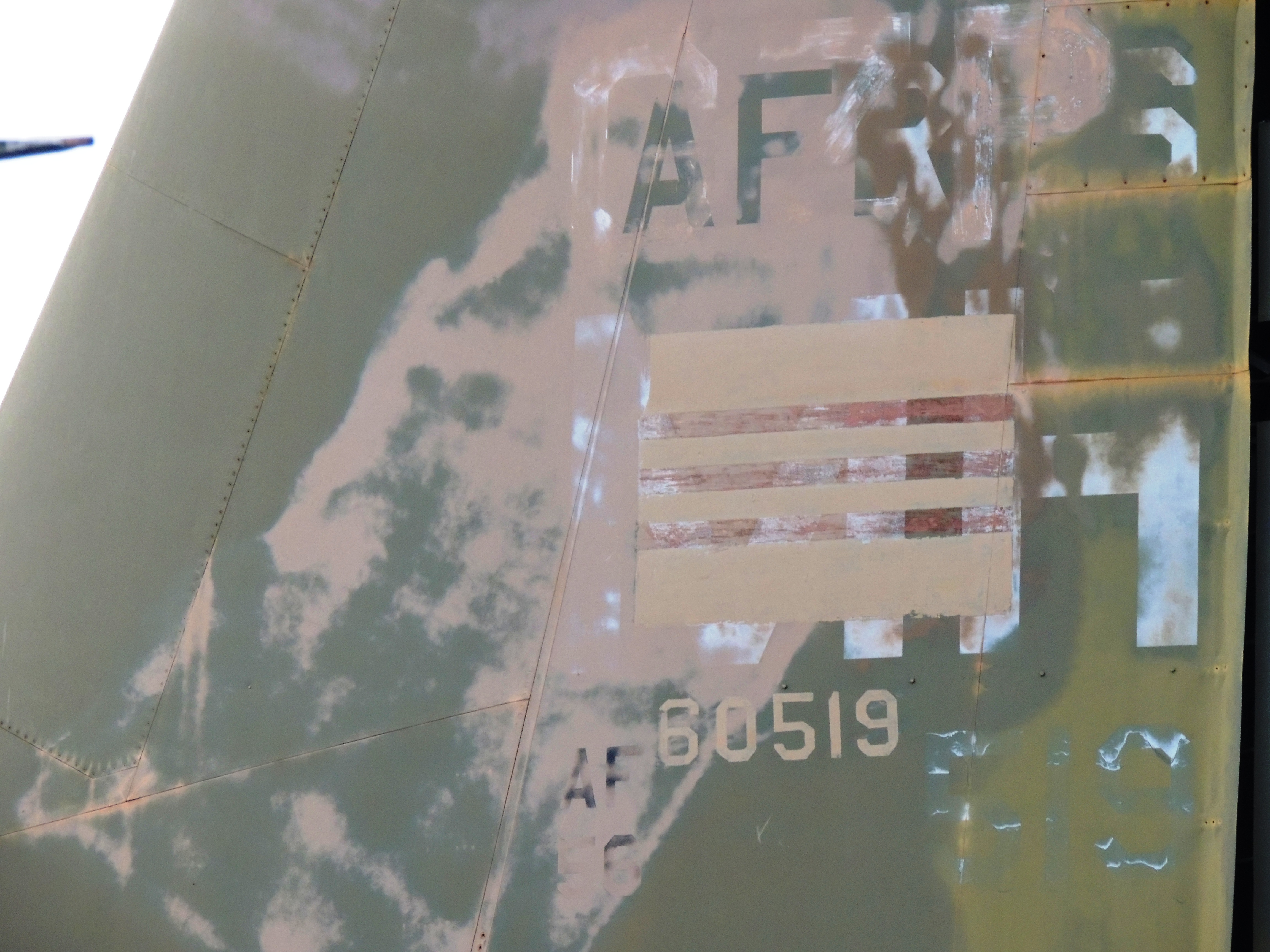

On 16.01.2014. at 10:02 PM, airfix1338 said:
next 56-0545 HCP-this is the correct tailcode for this aircraft(it is not 56-0519-this is GZP- I have many pictures of this aircraft from the internet!)
Check this pic out. Bob
Hi, I did find this one, URL]
Could not find your pic. I have never had a confirmed list of the Vietnamese A's.
Lots of guesses though.
The two pics below confuse me in this case. The second clearly shows 56-0519 and HCP, the first even though not as clear shows 56-0519 as GZP?
Bob
