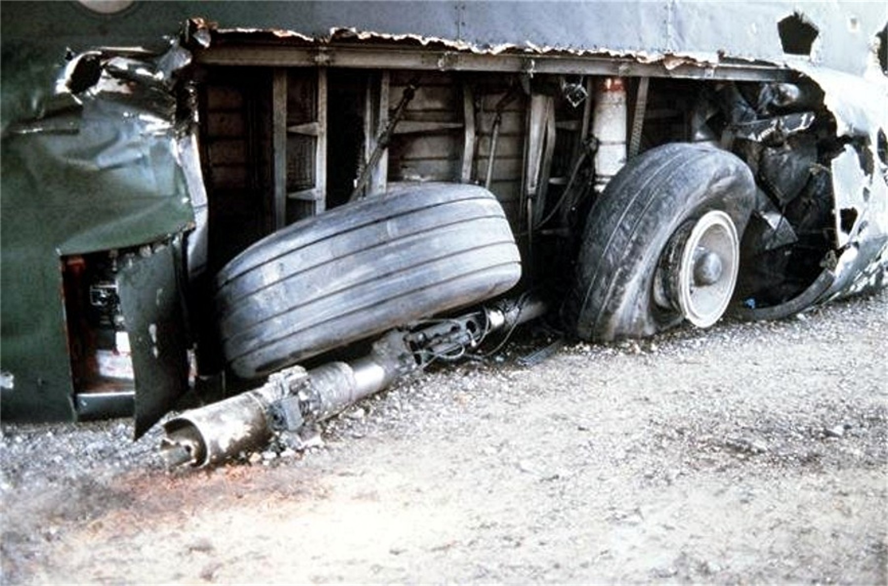

Oh, also 68-10946 was a hard landing at Giebelstadt AAF, West Germany in 1984.  If I remember correctly, it was during an ORI with a mostly stan/eval crew.  I think this photo was taken by the loadmaster.
Don That is the one I listed above, Thanks, Bob
68-10946 Stars and Stripes article from it's crash. I was a crew chief there when it happened. First day of a ORI. It was carrying ORI inspectors to Giebelstadt for the exercise. 68-10944 went down in Spain (also a 37th bird) killing all crew and pax. 0945 was involved in a incident at Pope with a F-16, I believe with it being wrote off. Poor old 946 as I understand actually crashed 3 times. The first (as I heard it back then) she slapped her belly on the water some where but made it back safely. Then this crash in Geibelstadt. Then after she was stripped and left at Geibelstact, turned into essentially a 40' culvert (the nose was put on the Franken Herc), a strong wind picked up the fuselage and blew in to a bunch of Army helicopters  causing a couple of them to be wrote off. I digress, my point was 0944, 0945, 0946 seemed to be a unlucky string on tail numbers. The first aircraft I crewed was 0943, I guess I'm glad the bad luck stopped where it was.
