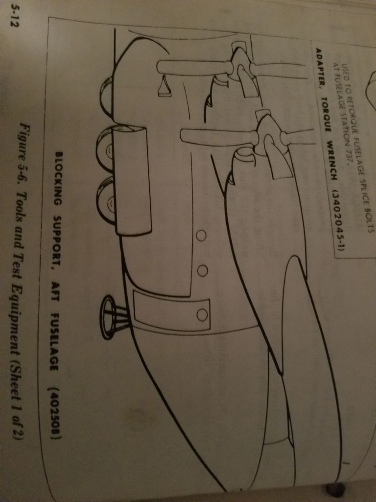

Might want to rethink using the milk stool for supporting the aircraft for all four engine removal as the milk stool is used to support the ramp for cargo loading, not for maintenance. There is a pad to the left of the tail skid that is meant to be used to place a specific made jack stand to support the aircraft during engine removal. Don't remember the T.O. that references this but it's there.
yea thats the support Im talking about.....it is the milk stool lol.
look at the photo, then do a google image search for milk stool and tell me where the name "milk stool" came from........

On 4/16/2018 at 1:58 AM, hehe said:
use tail support stand (milk stool), thats what it is for
When aircraft on cradles and Jack no need required for this stool.
Yes u r right this not use for engine removal & not required any support for engine removal / installation when airctaft already on crafles and jacks.
