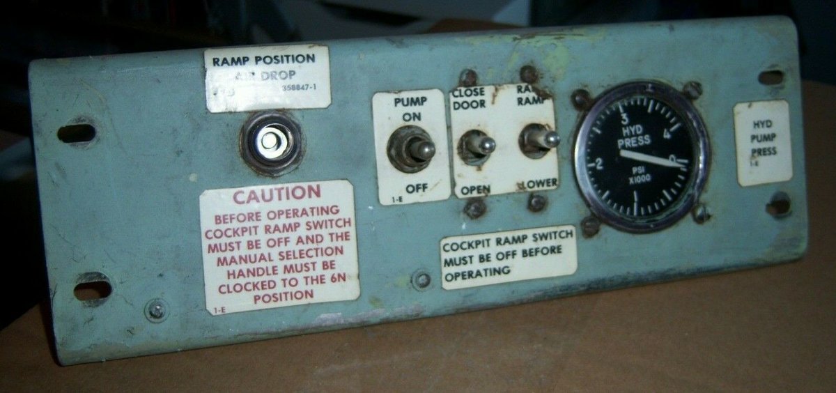

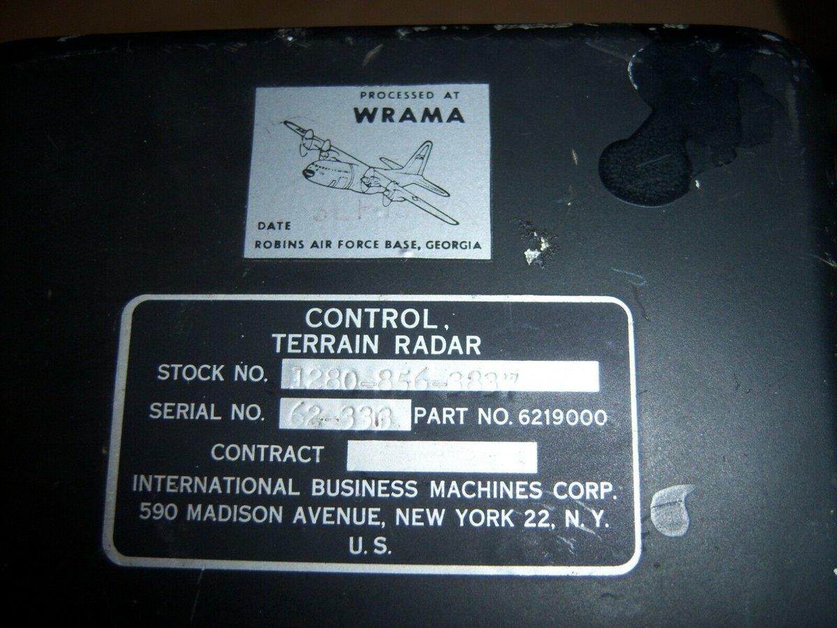

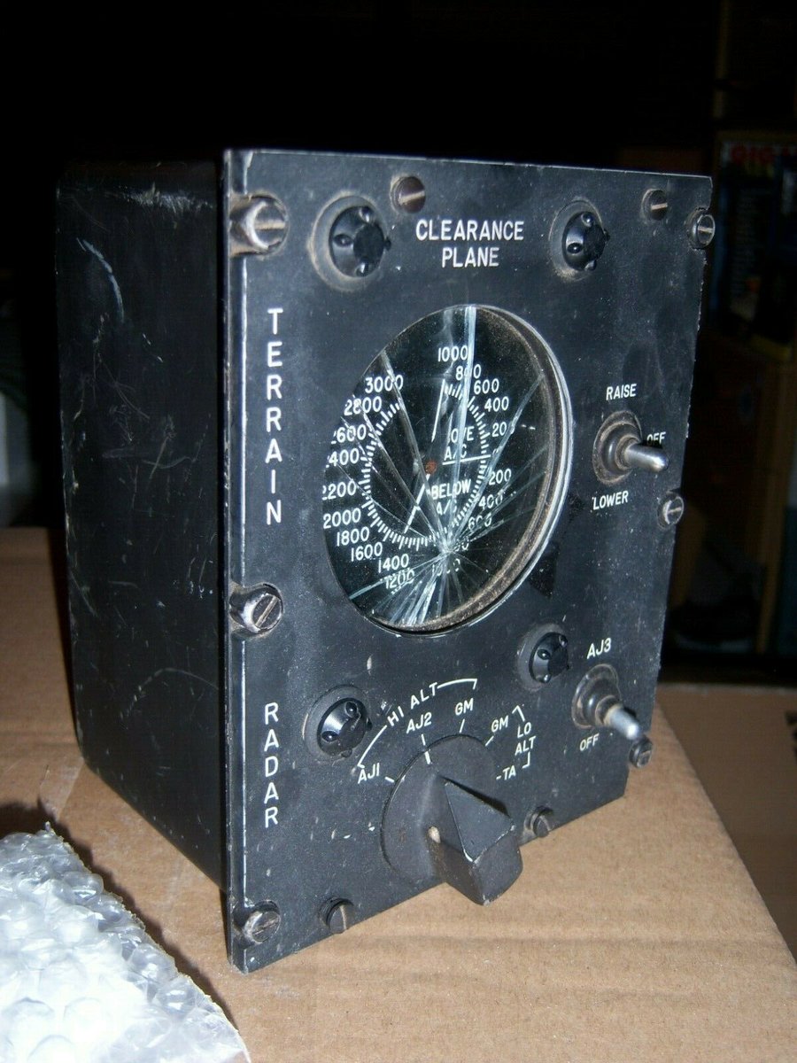

LAURENT Posted September 5, 2019 Share Posted September 5, 2019 Hi, Can you help me to identify these two Lockheed C130 aircraft parts?.And where these parts were located in the C130. These parts are for an old or current aircraft? Thank you so much for your help. Laurent Quote Link to comment Share on other sites More sharing options...
hlg6016 Posted September 6, 2019 Share Posted September 6, 2019 I cant help you with the black box it's an Air Force specific system, The Hydraulic panel is the control panel for the aft cargo door and ramp. Are you putting together your own air craft? Quote Link to comment Share on other sites More sharing options...

LAURENT Posted September 7, 2019 Author Share Posted September 7, 2019 Thank you for your comments.About your question, no i do not build an aircraft, but i'm looking for some little C130 A / B parts. Laurent 14 hours ago, hlg6016 said: I cant help you with the black box it's an Air Force specific system, The Hydraulic panel is the control panel for the aft cargo door and ramp. Are you putting together your own air craft? Quote Link to comment Share on other sites More sharing options...

Spectre623 Posted September 7, 2019 Share Posted September 7, 2019 Hi Larry, how you been doing? That hyd. panel would be off a B model or newer as the A models didn't have an AUX pump. I remember having to hand pump the ramp and door open the 3 years on A models at Sewart AFB TN. UGH!!! Thought I was in Herky heaven when I went on B's at Clark AB P.I. Quote Link to comment Share on other sites More sharing options...
larry myers Posted September 7, 2019 Share Posted September 7, 2019 Good morning Spectre, For a burned out old geezer am in pretty good shape. Except for an on duty back injury incurred while chasing a hooker down the alley behind the Blue Angel. I agree with you concerning the origin of Laurent's ramp and door hydraulic control panel. Although I spent four years in an "A" model outfit, never opened the ramp and door. The reason being our aircraft were configured for a classified mission resulting in all the ramp and door hydraulics being removed and the ramp and door being semi-permanently closed. Opened only during PDM. Had the same experience as you going from "A"s to "E"s. Quote Link to comment Share on other sites More sharing options...

tinyclark Posted January 11, 2020 Share Posted January 11, 2020 I am 99.9% positive this control box is not a C-130 part. There have been many itterations of Terrain RADAR. This looks like it was used for landing, at least to me. Just becuase it has a WR sticker on it means nothing, except WRALC has been a dedicated RADAR repair facility since Christ was a corporal. If you are that interested, maybe hit the IBM home page and contact them about it. Someone may track it down for you. Good luck. Quote Link to comment Share on other sites More sharing options...
