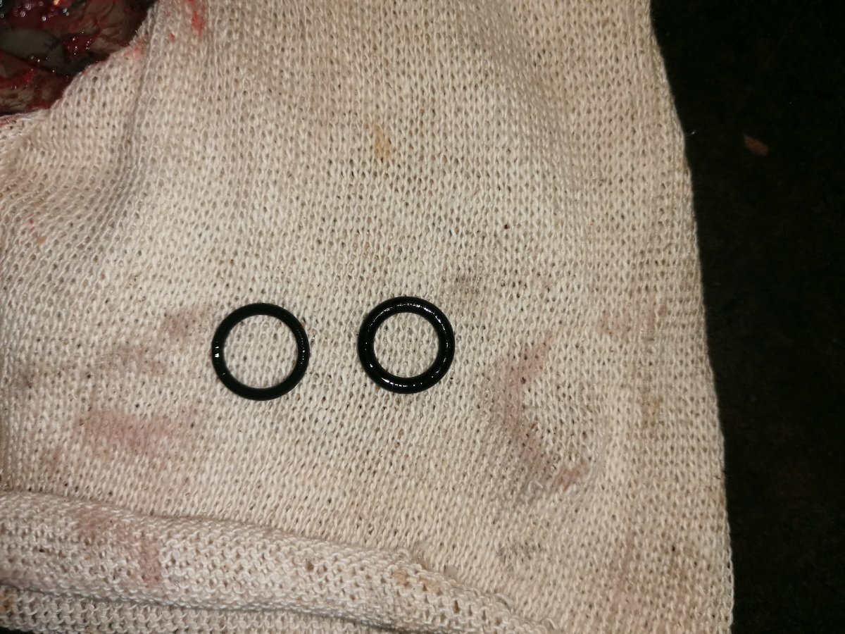

Rudi Posted August 17, 2021 Share Posted August 17, 2021 Good day Can someone please tell me what o-ring do you use on you multi disc brake between the brake and shuttle valve? As we have two types of o-rings but they differ. Quote Link to comment Share on other sites More sharing options...
tinyclark Posted August 21, 2021 Share Posted August 21, 2021 Looking at the picture and the question, the one that fits and doesn't leak. Why not use the IPB? Quote Link to comment Share on other sites More sharing options...
Leakybirds Posted November 5, 2021 Share Posted November 5, 2021 We use a -906 and 2 -110 I’m assuming you’re talking about the fluid bolt attaching shuttle valve to brake. 3 o-rings fit it. Quote Link to comment Share on other sites More sharing options...
Moch. Dennis Posted March 27, 2022 Share Posted March 27, 2022 Use the proper spare But, if there is no one (base on TO). You can use -6 for the alternate Quote Link to comment Share on other sites More sharing options...
