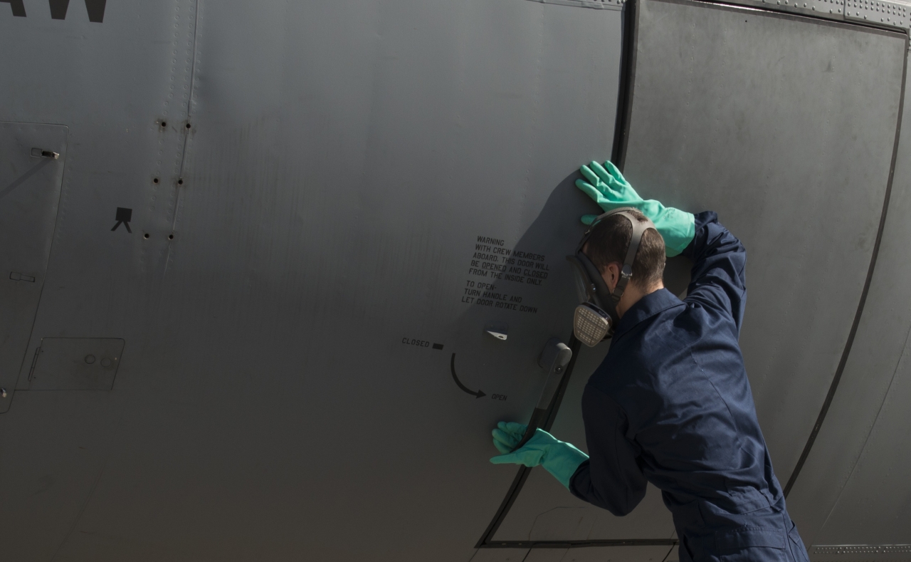

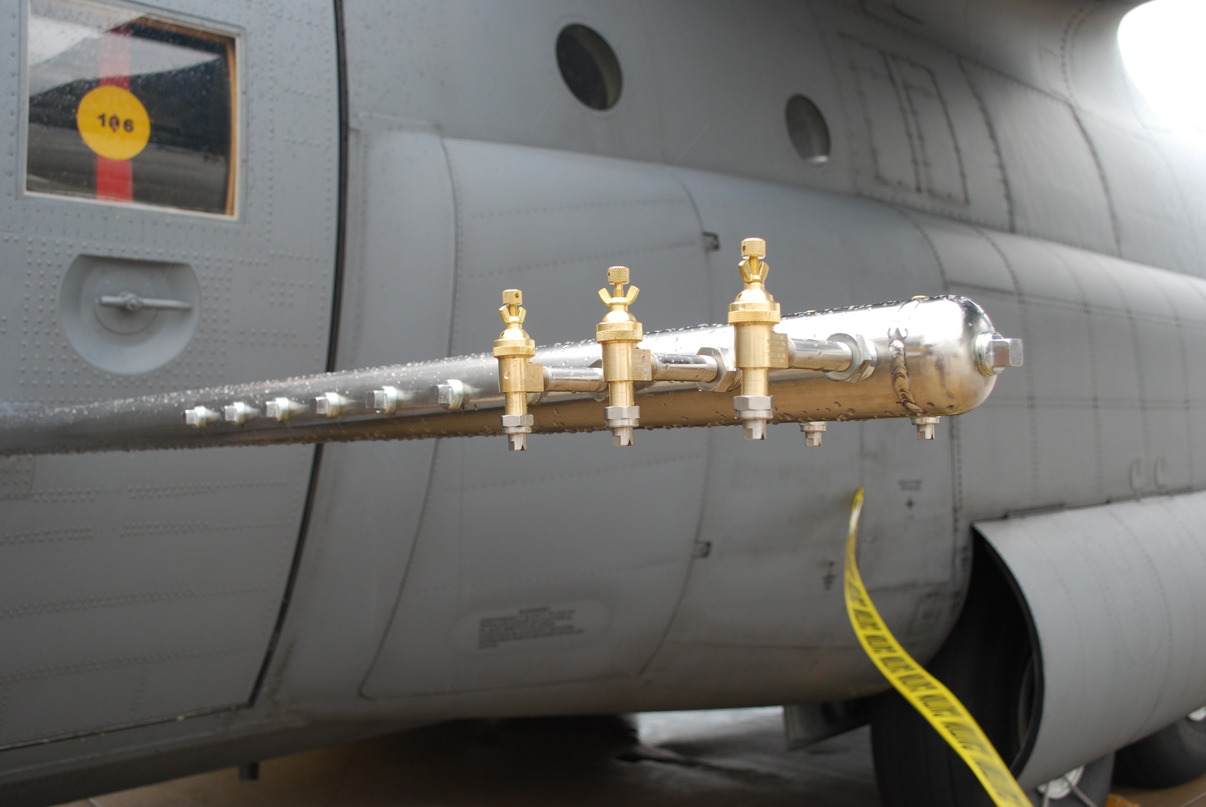

Robert Podboy Posted February 9, 2016 Share Posted February 9, 2016 The 910th is home to the DoD’s only aerial spray capability and dedicated aerial spray maintenance flight. The mission: http://www.youngstown.afrc.af.mil/Portals/12/documents/MASTER Wing mission briefing 12092015.pdf?ver=2016-02-03-081707-173 A ride with the mosquito hunters: https://www.youtube.com/watch?v=ZrKScG4yaOI Quote Link to comment Share on other sites More sharing options...
