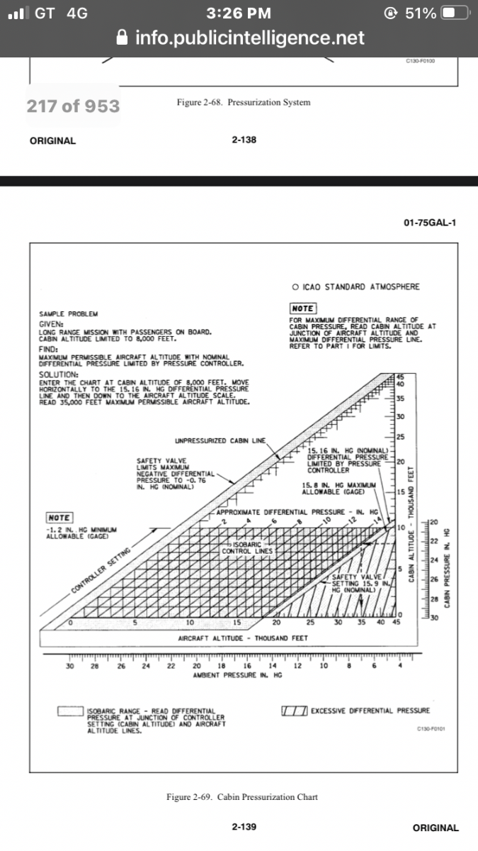

EdChao Posted December 21, 2022 Share Posted December 21, 2022 Hello, I would like to know how to read cabin pressurization chart as attachment? And how much the differential pressure can be acceptable when aircraft altitude higher than 10,000ft. Forgive me for asking a not so smart problem here, please.🥴 Quote Link to comment Share on other sites More sharing options...
Riyan17 Posted March 7, 2024 Share Posted March 7, 2024 To read a cabin pressurization chart, first, understand the altitude range on the horizontal axis and the corresponding cabin pressure on the vertical axis. The chart typically displays lines representing different aircraft altitudes. To interpret, find the altitude your aircraft will fly at and trace vertically to see the corresponding cabin pressure. Ensure the pressure remains within safe limits for passenger comfort and crew safety. Quote Link to comment Share on other sites More sharing options...
