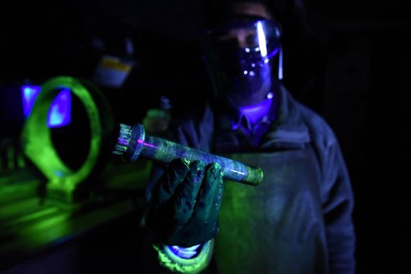

Chemical tanks, conveyer belts and intricate machines line the walls of the 19th Maintenance Squadron nondestructive inspections shop.
The lights are turned off as one ultraviolet light shines a new spectrum of colors to an NDI technician.
Shades of purple, blue and neon-green light up the dark as the Airman searches for what the naked eye can’t see.
Just as a special investigator uses black lights searching for clues, NDI Airmen use them to identify potential cracks in a variety of aircraft parts.
“We specialize in preventative maintenance,” said U.S. Air Force Staff Sgt. Derik Shannon, 19th MXS NDI craftsman. “We use noninvasive ways to inspect aircraft for defects.”
NDI Airmen stationed at Little Rock Air Force Base, Arkansas, use five methods to detect discrepancies: magnetic particle, fluorescent penetrant, X-ray, ultrasonic and eddy current.
Each method uses a distinct technique to safeguard a C-130J’s structural integrity.
Two procedures unique to the NDI shop are magnetic particle and fluorescent penetrant which use fluorescent liquid, and ultraviolet lighting to illuminate small structural flaws.
X-ray and ultrasonic are two other methods that enable NDI Airmen to inspect the structural inside of any part without disassembling it completely, using radiation and sound energy.
Eddy current, the most common method, consists of infusing electricity into an object creating an opposing magnetic field. Interruptions found within the field are identified as cracks and marked.
