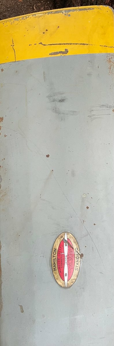

plugnpray Posted November 7, 2021 Share Posted November 7, 2021 Hello, I have acquired an old C130 propeller blade online. It is painted gray with yellow tips. However the paint is in poor condition and I intend to repaint it to place it in the loft. I have done a lot of search but have not been able to find the right paint number.Attaching a picture here to see if someone can shed some light on the FS# for this color. Thanks in advance Quote Link to comment Share on other sites More sharing options...
Metalbasher Posted November 8, 2021 Share Posted November 8, 2021 Likely SAE AMS-STD 595 Color No. 13538 yellow Quote Link to comment Share on other sites More sharing options...
plugnpray Posted November 10, 2021 Author Share Posted November 10, 2021 On 11/8/2021 at 11:00 AM, Metalbasher said: Likely SAE AMS-STD 595 Color No. 13538 yellow Thank you very much, let me try to look it up Quote Link to comment Share on other sites More sharing options...
plugnpray Posted November 10, 2021 Author Share Posted November 10, 2021 On 11/8/2021 at 11:00 AM, Metalbasher said: Likely SAE AMS-STD 595 Color No. 13538 yellow Also any ideas on the gray ? Quote Link to comment Share on other sites More sharing options...
Metalbasher Posted November 15, 2021 Share Posted November 15, 2021 Sorry, never saw a blade painted grey. I know as long as I can remember the blades were always bare metal and only the tips were painted. If I were to guess maybe # 16473 gloss grey but not sure. Quote Link to comment Share on other sites More sharing options...
pjvr99 Posted November 16, 2021 Share Posted November 16, 2021 Only the tip and deicing boot is painted, rest is bare metal Quote Link to comment Share on other sites More sharing options...
