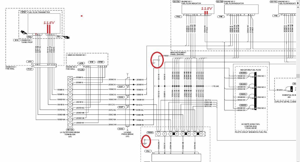

No Fuel Flow Indicating at the flight deck
I would ensure the 28V is getting to the power supply on pin B, as well as the ground on pin A, which is aircraft bonded.
Also, the ground for the transmitter and indicators are tied to one aircraft ground. Since all four are affected, I would insurepower is good to everything before I started with anything else.
