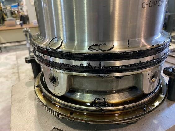

JTECH Posted January 12, 2024 Share Posted January 12, 2024 hey Herc world, we have an issue with H model props with premature dome quad seals breaking down prematurely, after under 1000hr operation. Standby filters are filled with particles and when the domes are removed there is substantial pieces of oring material in the domes and even enough to plug ports in the PLR. anyone else experiencing this? Quote Link to comment Share on other sites More sharing options...
Lkuest Posted January 27, 2024 Share Posted January 27, 2024 The dome shell could have excessive roughness. You could also have a newbie on the flightline topping your propeller up with engine oil. Quote Link to comment Share on other sites More sharing options...
