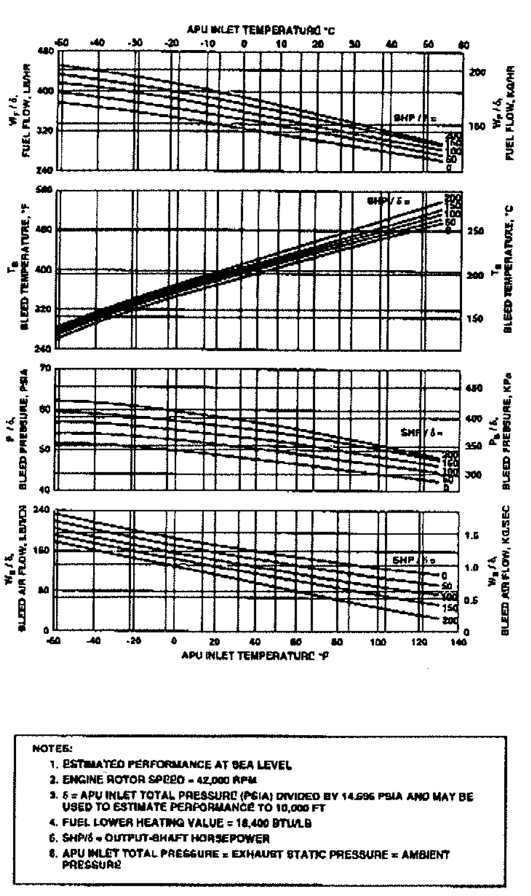

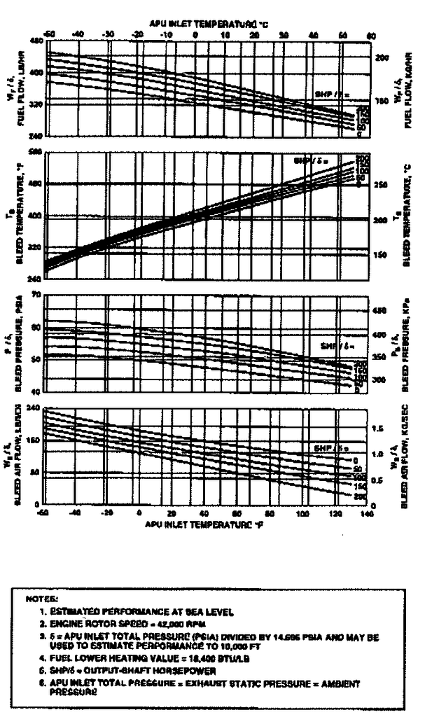

victorp1 Posted August 29, 2017 Share Posted August 29, 2017 This is a portion of the Specification Data for Model Garrett 850185[L] APU. Quote Link to comment Share on other sites More sharing options...
