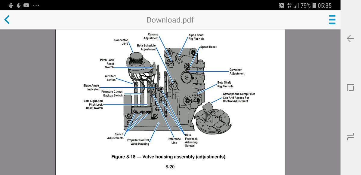

I know there is an air start switch in the valve housing. Could this be the cause of the engine failing to air start? Can anyone explain the function of the Air Start switch in the valve housing. Thanks.

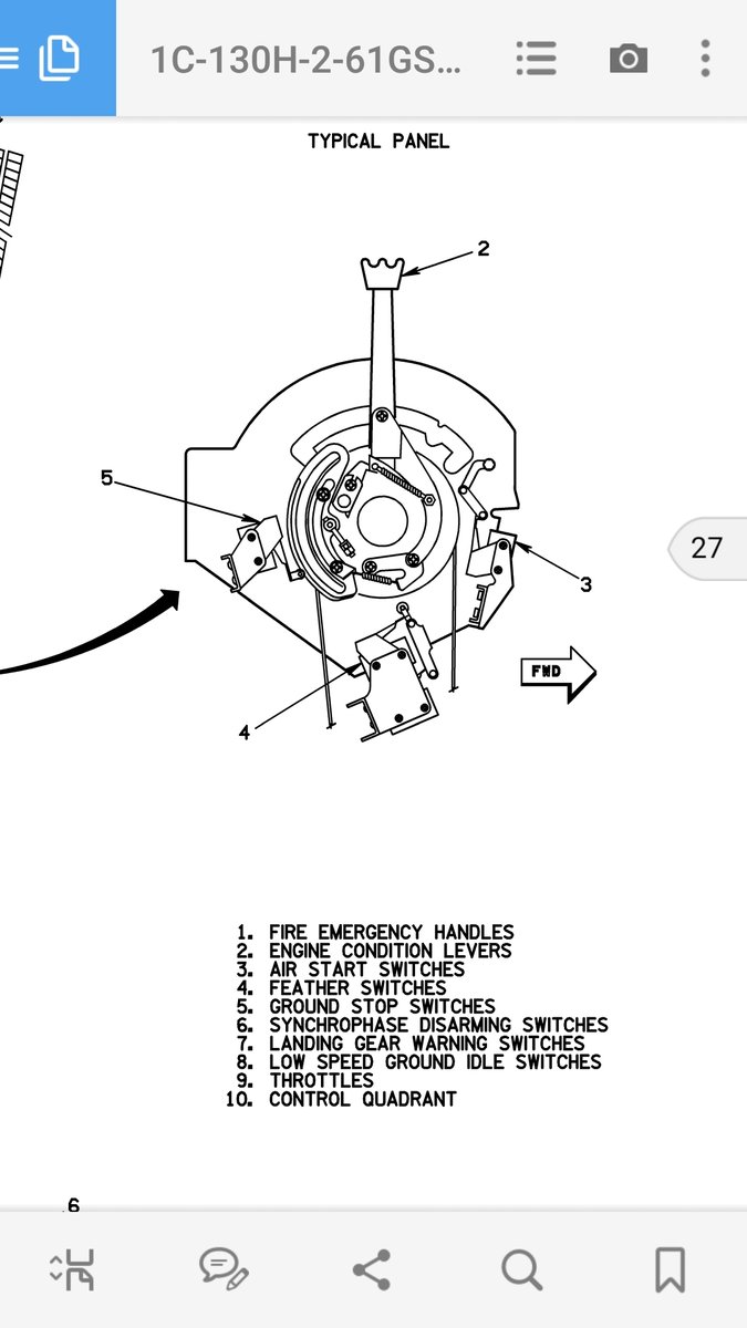

There is no air start switch in valve housing, condition lever air start position is is used during propeller hydraulic servicing , prop rigging on ground and air start the engine in air. The micro switch in condition lever actuate the prop aux pump motor when we select the condition lever to air start.
may b SHOLA is talking about AIR START CIRCUIT.... because air start switch is not in valve housing.....
NOT SURE BUT MAY B THIS SWITCH IS AVAILABLE IN ELECTRONIC VALVE HOUSING....
Thank you very much. I saw a diagram of the valve housing showing air start switch. Hence, my curiosity.
