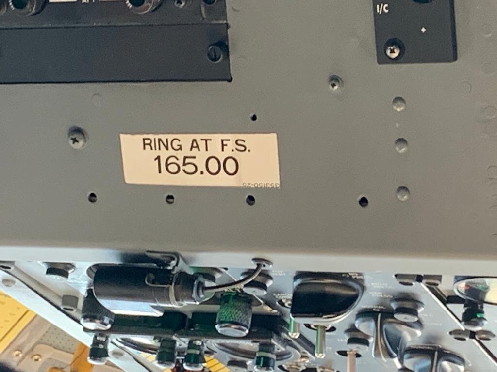

Tonka Posted May 30, 2022 Share Posted May 30, 2022 Hello, We fly with four H planes, 2 of them are -30, one of the -30 planes have a placard above the FE panel that says: RING AT F.S. 165 We have no idea what it means, anybody does ?? Marcel the Netherlands Quote Link to comment Share on other sites More sharing options...

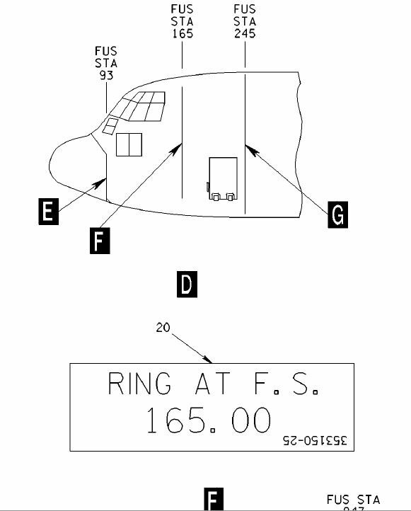

hehe Posted May 31, 2022 Share Posted May 31, 2022 This is just a marking for the ring segment at fuselage station 165. The fuselage is essentially just a bunch of beefed up rings connected together. Quote Link to comment Share on other sites More sharing options...

Tonka Posted June 8, 2022 Author Share Posted June 8, 2022 Quote Link to comment Share on other sites More sharing options...
tinyclark Posted June 12, 2022 Share Posted June 12, 2022 (edited) Someone was screwing around, This goes on the ring segment at FS 165. Funny they taped over it when they painted at depot. "It ain't my job to remove it." It's been a while since I've been on an airplan, but I swear I've seen them before on the overhead panel. Tiny Edited June 12, 2022 by tinyclark Quote Link to comment Share on other sites More sharing options...
tinyclark Posted June 15, 2022 Share Posted June 15, 2022 Actually, the ring segement would probqbly be right under the panel, though I don't know why they would mark it there. Quote Link to comment Share on other sites More sharing options...
