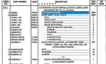

tinyclark Posted September 3, 2022 Share Posted September 3, 2022 Yes, the synchrophaser was installed by TCTO 1C-130-936 or 1095 when the props were modified. Don't know what they had before that. Quote Link to comment Share on other sites More sharing options...
