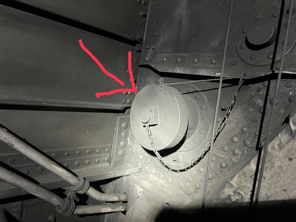

superbigbig Posted September 27 Share Posted September 27 (edited) Does anyone know the use of this device in C-130H? I asked a senior before that this is the position where the fuselage is pressurized when the aircraft leaves the original factory. Is this correct? Edited September 27 by superbigbig Quote Link to comment Share on other sites More sharing options...
tinyclark Posted September 28 Share Posted September 28 Where is it located? Quote Link to comment Share on other sites More sharing options...
ROCAF LM Posted September 29 Share Posted September 29 13 hours ago, tinyclark said: Where is it located? In left main landing gear cabin Quote Link to comment Share on other sites More sharing options...
tinyclark Posted September 29 Share Posted September 29 It is named the Pressure test fitting in the TO and I can't find any real info on using it. The old 1C-130B-2-10 shows the fitting, but the book is not specific about hooking it up. This was back in the day when knowledge was handed down. It says to use an air cart though. "d. Start the MA-1A and pressurize the bleed air manifold." Suffice it to say, it was probably put there for manufacturing purposes to check the aircraft before any power was put on it to run the GTC. 1 Quote Link to comment Share on other sites More sharing options...
superbigbig Posted September 30 Author Share Posted September 30 Thank you for your reply. I also found it on our 1C-130H-2-10 PAGE3-3, but there is still no way to use it. I heard our senior maintenance staff said that it does not use any engine or APU. In this case, use a cabin pressure truck to test the fuselage pressure. 1 Quote Link to comment Share on other sites More sharing options...
Steve1300 Posted 7 hours ago Share Posted 7 hours ago If you do a search of the original build of the C-130, you'll find pictures of the original fuselage being submerged in a large pool and it was pressurized using that fitting to check for leaks and the pressure of final damage. The fitting was never taken out of the engineering drawings, so it is still there today. Quote Link to comment Share on other sites More sharing options...
