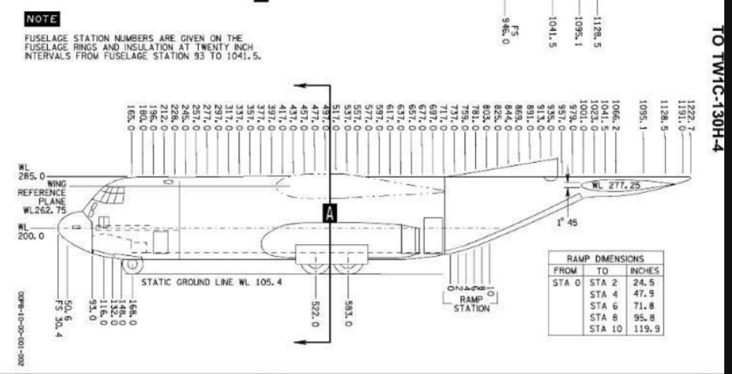

superbigbig Posted March 19, 2024 Share Posted March 19, 2024 Why is the C130 waterline starting point 105.4 inches? Why isn't it calculated from 0 inches from the ground, like the cargo compartment floor waterline being 146 and the cockpit being 200? Quote Link to comment Share on other sites More sharing options...
tinyclark Posted June 11, 2024 Share Posted June 11, 2024 I remember being told that this was because of the aircraft sitting in the building jigs, which was higher than the aircraft sitting on the ground. Quote Link to comment Share on other sites More sharing options...
