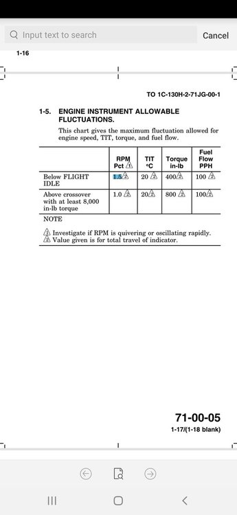

if by weather you mean cloud or rain, changes in air density going into compressor will be
detected by fcu cip & cit probes. as the throttle is already pulled back, a weak valve housing
may not be able to hold the rpm steady. 1c-130h-2-71jg-00-1 gives rpm 1.5% total travel
with throttle below flight idle, and 1.0% with throttle above x-over and more than 8000"lb
torque. valve housing change is the quicker fix, but you may end up changing fcu. as an
after-thought, check the time on dome quad-seals.
Thank you pjvr99. By weather I meant cloud. Every time during decending rpm travel 99.5 to 100.5 at all modes with frequency. Fuel flow and tit stable and no fluctuations.
Did you mean bellow crossover 1.5 total travel allowable? If it is can you send me a screenshot or if you can send me to pmostafiz@gmail.com.
If fuel flow and tit stable, should I go to Fcu?
I am thinking about V/H.
What is your opinion?

yes, thats it. if your rpm flux is only +-0.5 you appear to be within limits. however, if the crew is
uncomfortable you will have to do something. out of curiousity, did you do a fuel governing
and pitchlock check?
Fluctuations allowable, above crossover: 1.5
Below flt idl: 1, what is allowable range of below crossover?? Because during decending throttle remain in-between flt idl and crossover.
I did not do pitchlock Ckeck. Can you describe for my understanding why it is important as everyone rpm stable and only fluctuates during decending.
Thanks
