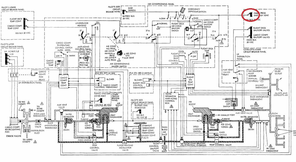

Check Team FR Posted March 20, 2021 Share Posted March 20, 2021 At the end of the flight, when the aircraft is reconditioned: When I set the Air conditioning Master Switch to OFF or AUX VENT, the breaker cabin press and AUX Vent triggers after 2 seconds. On positions NO PRESS, PRESS MAN or AUTO PRESS, the breaker does not trip ... I have a doubt about a piece of equipment but I would like to have your avionics opinion. Thank you Quote Link to comment Share on other sites More sharing options...
munirabbasi Posted March 20, 2021 Share Posted March 20, 2021 4 hours ago, Check Team FR said: At the end of the flight, when the aircraft is reconditioned: When I set the Air conditioning Master Switch to OFF or AUX VENT, the breaker cabin press and AUX Vent triggers after 2 seconds. On positions NO PRESS, PRESS MAN or AUTO PRESS, the breaker does not trip ... I have a doubt about a piece of equipment but I would like to have your avionics opinion. Thank you Check wiring of air-conditioning system O IC-130B-13 Safety valve , with disconnect of Outflow valve and aux vent systems connectors one by one see attach schematic Munir Abbasi Quote Link to comment Share on other sites More sharing options...
Check Team FR Posted March 21, 2021 Author Share Posted March 21, 2021 Thank you I had a second info and when we set the cargo switch and air cond shutoff switch to OFF, the breaker is also triggered after 2 seconds. After a little more in-depth research, we think Flow control shutoff valve cargo, it remains open and trips the breaker when closing. We're going to test the power line just in case, but we're going to replace the valve. Quote Link to comment Share on other sites More sharing options...
