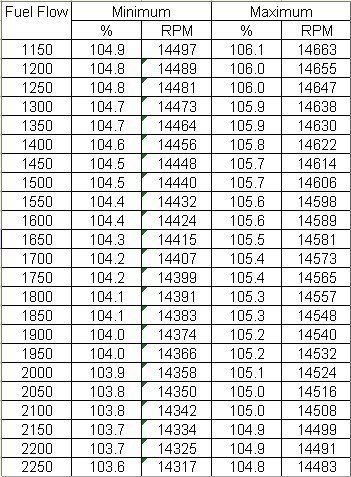

pjvr99 Posted January 25, 2008 Share Posted January 25, 2008 Different languages, different meaning, same words. US Navy guys talk about the \'fuel topping governor\', while the rest talk about \'fuel control governor\'. In South Africa and the UK we talk about \'topping up\' the tanks, while Americans talk about \'topping off\'. BTW fuel governor rpm for -A15/D22A 103.6% to 106.1%, and -7/D22 is 103.6 to 105.8% Quote Link to comment Share on other sites More sharing options...

Dan Wilson Posted January 25, 2008 Share Posted January 25, 2008 Okay guys, as much as it pains me I am missing some numbers in my head. What RPM did fuel topping occur, initially I was thinking 103.5% but now I have 105% popping up in my head, which was it? And then pitchlock was at 103% or 103.5%? Jeez this sucks Dan Quote Link to comment Share on other sites More sharing options...
C130H2FE Posted January 26, 2008 Share Posted January 26, 2008 Just remember, the Prop goes first, 103, then the engine 103.5. Quote Link to comment Share on other sites More sharing options...
pjvr99 Posted January 26, 2008 Share Posted January 26, 2008 ..... bearing in mind when the prop does over-speed, the fuel conrol governor rpm is set according to fuel flow, which mostly is around 104.5% to 105.5% Quote Link to comment Share on other sites More sharing options...
HerkPFE Posted January 26, 2008 Share Posted January 26, 2008 pjvr99 wrote: ..... bearing in mind when the prop does over-speed, the fuel conrol governor rpm is set according to fuel flow, which mostly is around 104.5% to 105.5% In my 25+ years of maintaining and being an FE on aircraft equipped with the T56 engine I have mainly seen the RPM ranges 104.5% to 105.5%. In fact the P-3A/B Natops(Navy -1 manual) has a caution note in the Fuel Governor Pitchlock test that if the RPM is between 105.5% and 106.0% to investigate that the propeller is not governing the RPM. Quote Link to comment Share on other sites More sharing options...

Dan Wilson Posted January 26, 2008 Share Posted January 26, 2008 Okay guys, thanks for the answers. What had me screwed up was I thought that 103.5 is what we always taught for fuel topping, but then I read that Lockheed manual the other day that said 104.5 to 105.5! Unfortunately I don\'t have any other references left to check it against and my pharmaceutical soaked brain just couldn\'t get out of the vapor lock it got into. I really wish I would have kept my books, but after I was med disqualified I got rid of a lot of stuff; it was pretty painful for the first year, still in the Air Force and in a flying squadron but cant fly anymore:( (they just didn\'t want to go for that 15th waiver) At least I finally got past that point so now when I see one of you guys buzzing the house I can say \"you lucky bastards\" and not hurt too bad! Dan Quote Link to comment Share on other sites More sharing options...
HerkPFE Posted January 26, 2008 Share Posted January 26, 2008 Dan Wilson wrote: Okay guys, thanks for the answers. What had me screwed up was I thought that 103.5 is what we always taught for fuel topping, but then I read that Lockheed manual the other day that said 104.5 to 105.5! Unfortunately I don\'t have any other references left to check it against and my pharmaceutical soaked brain just couldn\'t get out of the vapor lock it got into. I really wish I would have kept my books, but after I was med disqualified I got rid of a lot of stuff; it was pretty painful for the first year, still in the Air Force and in a flying squadron but cant fly anymore:( (they just didn\'t want to go for that 15th waiver) At least I finally got past that point so now when I see one of you guys buzzing the house I can say \"you lucky bastards\" and not hurt too bad! Dan Dan, Everytime we have moved, my wife has bitched me out for all the \"books\" I have kept. It wasn\'t until after I retired and we started really mingling with old squadron mates that she figured out some of the things we did. I have been a FE on P-3A/B/C, C-130A/E/G/H/T, B727-100/200, L1011-50/100/250/500, L-188, KC-97G, C-118, DC-8 and have the flight manuals (at the least) for each of them. For the L1011 I have over 70 pounds of manuals and charts...I know that because I shipped them al at one point to someone I was consulting with about operating a couple L10\'s I feel for you for being DQ\'ed for flying. The only thing I think that was worst was the Navy...being a FE was a collateral duty and you had to perform your primary MOS/NEC also. I was a Aviation Metalsmith (airframe/flight control/LG/HYD...etc.) so I ran the airframe shop, when I got to be an E-6 started working QA, and Maintenance Control and flying 40 to 100 a month also. Got passed over numerous times for E-7 since I would not give up flying...in the whole Navy during the 80\'s and 90\'s there was only openings for 14 E-7 C-130 FE\'s, 4 E-8 and 2 E-9\'s. So it was tought to be promoted to E-7, E-8 or E-9 and knowing you would be grounded...and it was a good chance in the great Navy wisdom to transfer you to a fighter or helo squadron where all your system knowledge would go to waste. Don\'t feel bad Dan, you have forgotten more then a lot of us ever knew. Quote Link to comment Share on other sites More sharing options...
agarrett Posted January 27, 2008 Share Posted January 27, 2008 Dan Wilson wrote: Okay guys, thanks for the answers. What had me screwed up was I thought that 103.5 is what we always taught for fuel topping, but then I read that Lockheed manual the other day that said 104.5 to 105.5! Unfortunately I don\'t have any other references left to check it against and my pharmaceutical soaked brain just couldn\'t get out of the vapor lock it got into. I really wish I would have kept my books, but after I was med disqualified I got rid of a lot of stuff; it was pretty painful for the first year, still in the Air Force and in a flying squadron but cant fly anymore:( (they just didn\'t want to go for that 15th waiver) At least I finally got past that point so now when I see one of you guys buzzing the house I can say \"you lucky bastards\" and not hurt too bad! Dan Dan, does “the fuel control starts to reduce the fuel to the engine at approximately 103.5 percent rpm†sound familiar? So the 103.5 was never a hard number, at least as far back as I can remember. Quote Link to comment Share on other sites More sharing options...
Dan Wilson Posted January 27, 2008 Share Posted January 27, 2008 Okay, thanks guys - I think I have all the numbers back where they should be At least the guys still working will have more use for the Lockheed manuals and Alison books than I will. What the heck, I still have my \"Herky Handbook\" and the -7 engine/prop Lockheed book that got missed in my housecleaning:cheer: Dan Quote Link to comment Share on other sites More sharing options...
pjvr99 Posted January 29, 2008 Share Posted January 29, 2008 Extracted from the 2J-T56-56: When throttles are at the wall during pitchlock check, check fuel flow, i.e. at 1550pph rpm should be 104.4 to 105.6 (for A15 engine) Quote Link to comment Share on other sites More sharing options...
