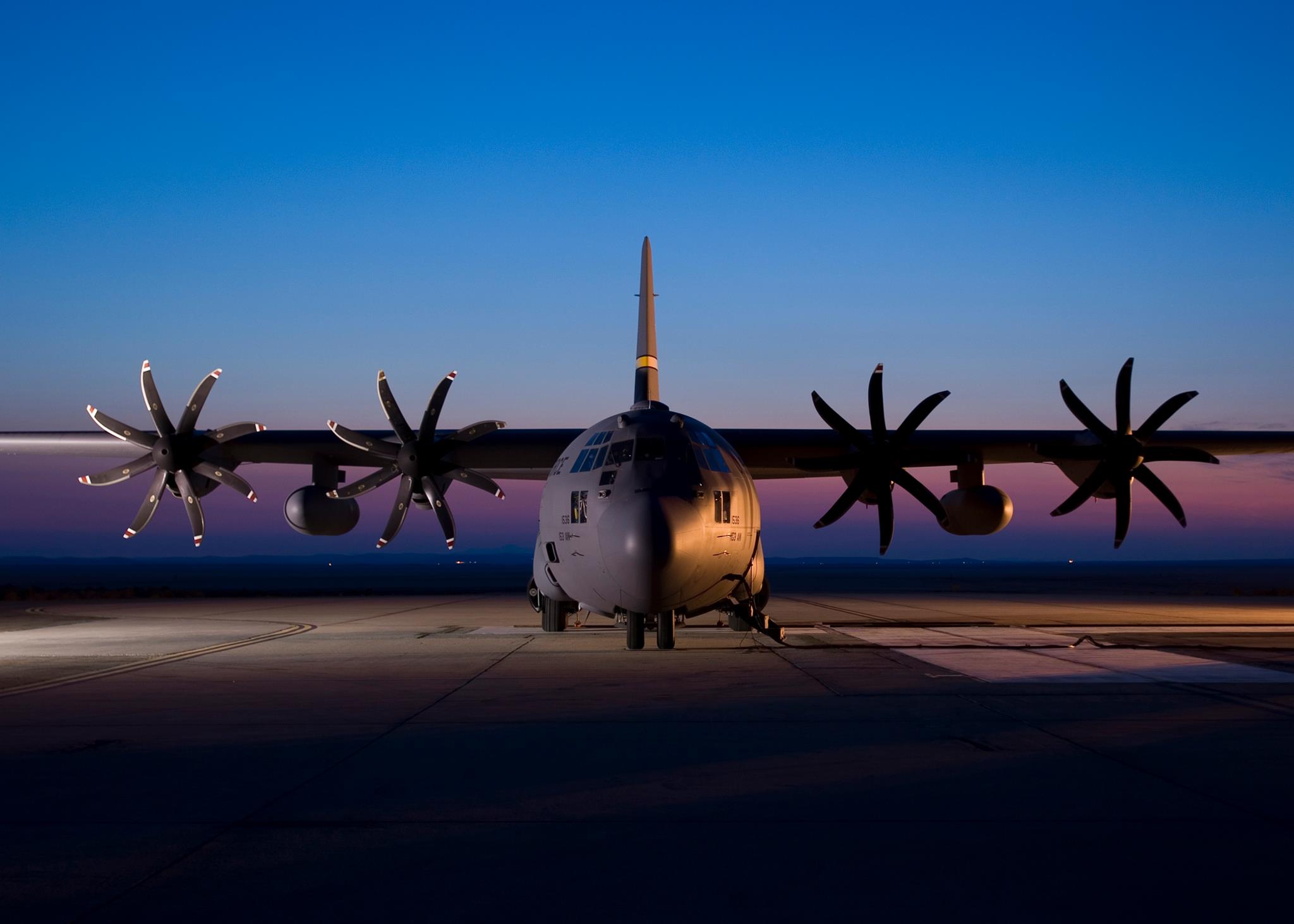

pjvr99 Posted October 25, 2015 Share Posted October 25, 2015 Hamilton-Sundstrand NP2000 is for the T56/501 engines. Saw some pics a while back of a ski-130 with the NP2000 in the ice - looks good. Dont remember where I got this, but its one of the best I've seen Quote Link to comment Share on other sites More sharing options...
hehe Posted October 25, 2015 Share Posted October 25, 2015 I believe that picture is from wyoming guard when they were testing the props.They tested them before the LC-130's got them. Quote Link to comment Share on other sites More sharing options...
AMPTestFE Posted October 26, 2015 Share Posted October 26, 2015 That picture is from the Edwards test period.The navy has been flying the 8-bladed prop for years. I hear nothing but positive stuff. Quote Link to comment Share on other sites More sharing options...
PerfManJ Posted October 27, 2015 Share Posted October 27, 2015 The Rolls Royce Series 3.5 engine upgrade is separate from any plans to use the NP2000 (8-blade) prop. Series 3.5 is an internal upgrade to several components of the T56 to improve fuel efficiency. Coincidentally, USAF used the same Wyoming ANG bird for the NP2000 and single-engine Series 3.5 test at Edwards. Then NOAA conducted their own 4-engine test on their P-3.Now, if USAF would combine the NP2000 and Series 3.5...that would be a sporty Herk. Quote Link to comment Share on other sites More sharing options...

PerfManJ Posted October 30, 2015 Share Posted October 30, 2015 NP2000 evaluation has been funded on and off for the past several years, but I believe the props have only been installed on a WYANG bird for the formal flight test and a Skibird for an operational test. The Skibirds will be the first to get them (once funding is approved) since they need the extra takeoff thrust to get off the ice in Greenland and Antarctica without JATO. The Skibirds have been the driver behind NP2000 for C-130s...but of course several other groups are interested in the extra performance as well.There is not much cruise fuel efficiency improvement with NP2000 (that's where the Series 3.5 engine really shines), but there is a major boost in low speed thrust. Plus many reliability and maintainability improvements over the 54H60. Quote Link to comment Share on other sites More sharing options...
