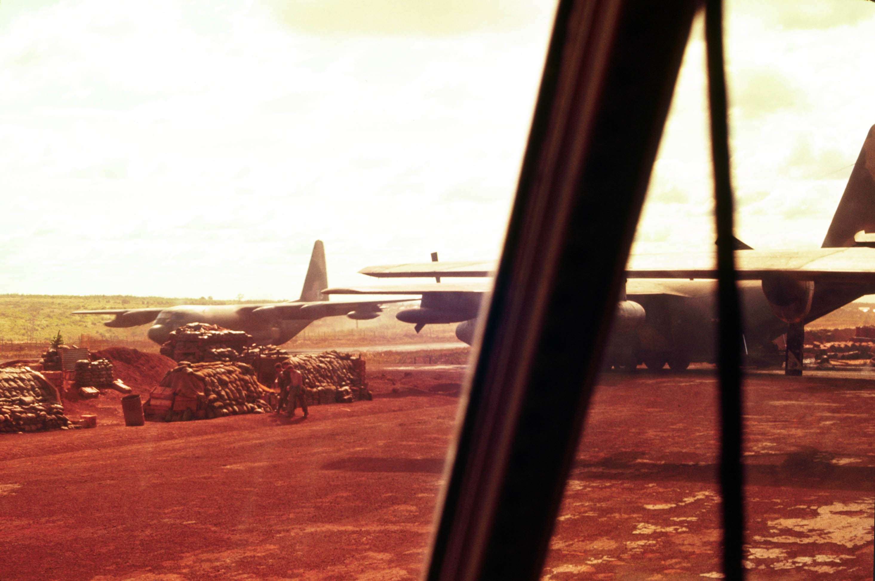

BRlang Posted May 30, 2016 Share Posted May 30, 2016 Here is a photo of ours at Song Be in the cuff. Always left one cuffed just in case..on't know the blade angleD Quote Link to comment Share on other sites More sharing options...

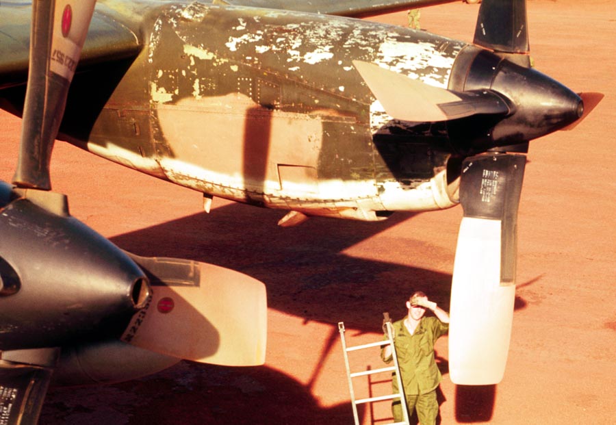

rc johnson Posted May 30, 2016 Share Posted May 30, 2016 Different view of 1 and 2. Same location. Quote Link to comment Share on other sites More sharing options...
pjvr99 Posted May 30, 2016 Share Posted May 30, 2016 75 - 80° by the look of it. common stopping position after feather shut-down Quote Link to comment Share on other sites More sharing options...
rc johnson Posted May 30, 2016 Share Posted May 30, 2016 Feathered Quote Link to comment Share on other sites More sharing options...

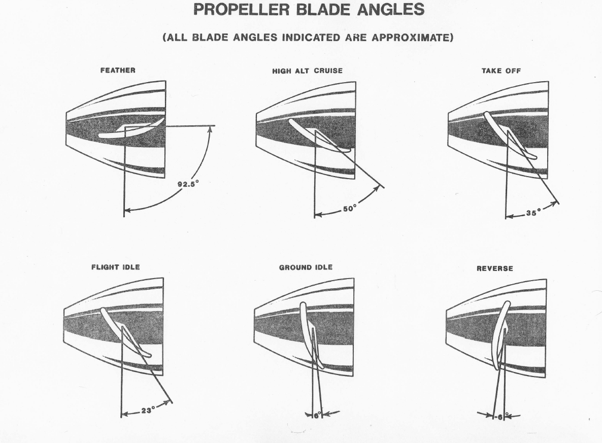

rc johnson Posted May 31, 2016 Share Posted May 31, 2016 Borrowing this from Alan Baker's site. Looks like cuffed angle = cruise angle. Quote Link to comment Share on other sites More sharing options...
AMPTestFE Posted June 1, 2016 Share Posted June 1, 2016 I would have guessed around 60 degrees looking at the pictures. Quote Link to comment Share on other sites More sharing options...
BRlang Posted June 1, 2016 Share Posted June 1, 2016 I think we answered Fred's question. Looks like 50 degrees based on the chart above. Now position the aircraft and start the check list. Quote Link to comment Share on other sites More sharing options...

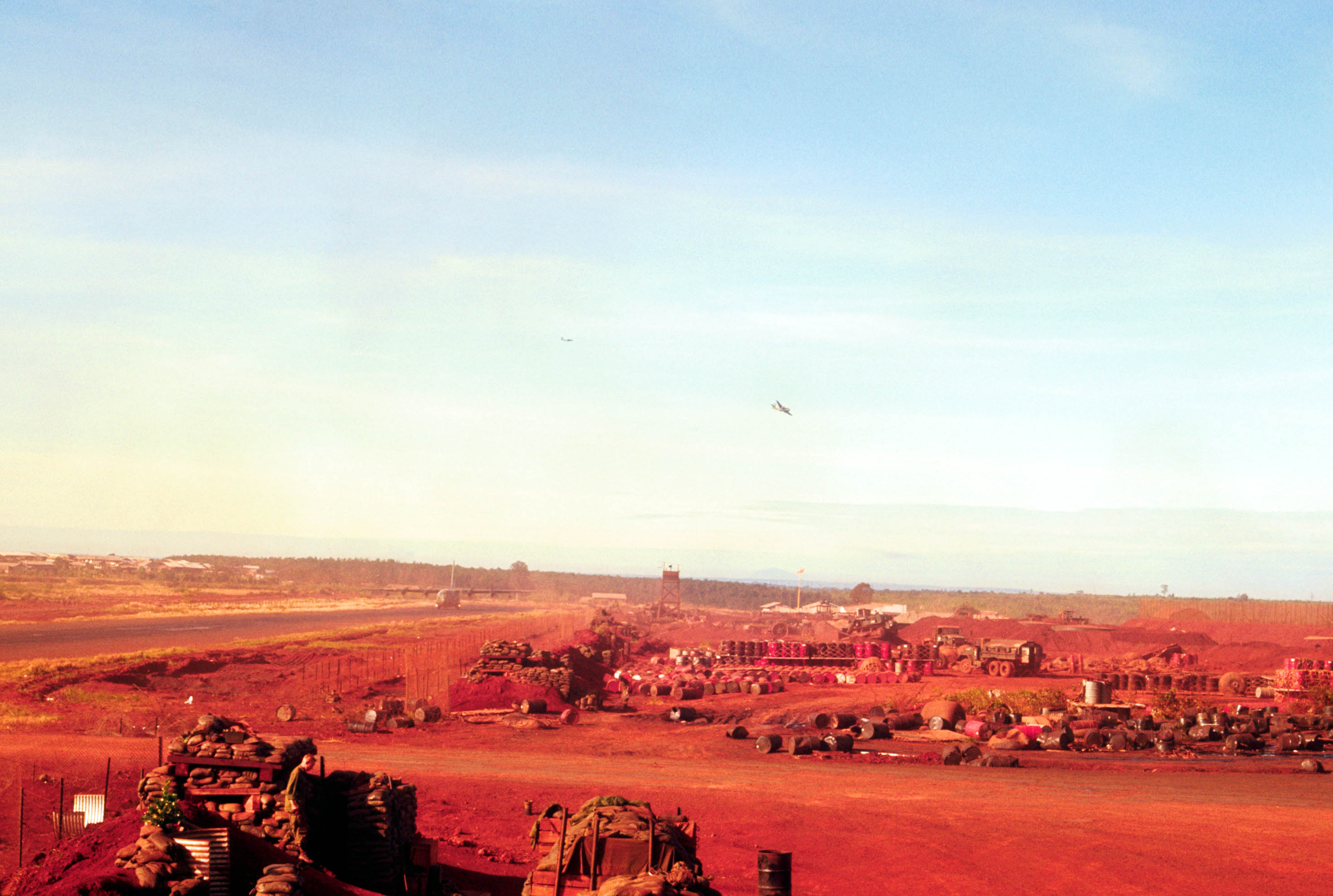

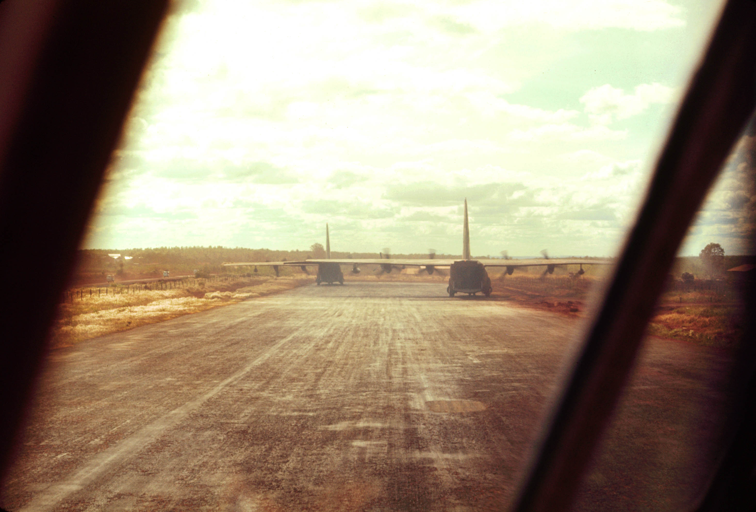

rc johnson Posted June 1, 2016 Share Posted June 1, 2016 Getting into position. They needed to bring in an A to start another A. Song Be, Dec. '69 (find the Christmas Tree) Quote Link to comment Share on other sites More sharing options...
