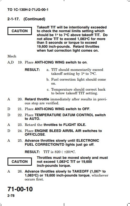

pmostafiz Posted January 23, 2020 Share Posted January 23, 2020 On 2/4/2019 at 9:51 PM, Ahmer said: This is correction of TIT 15 to 60 °c not a cut back its miss consecpt.as per 1c-130B-2-4CL-1. But new JG 1c-130H-2-71JG-00-1 having no 15 to 60°c limit its only 800 to 840 limit of cross over TIT no correction mentioned here. Dear Ahmed, Can you send me a screenshot of new JG 1c-130H-2-71JG-00-1 having no 15 to 60°c limit its only 800 to 840 limit of cross over TIT no correction mentioned here. Please send me. We are facing problem with our engine as tit correction written 15 to 60 written on 1c-130B-2-4CL-1. Quote Link to comment Share on other sites More sharing options...

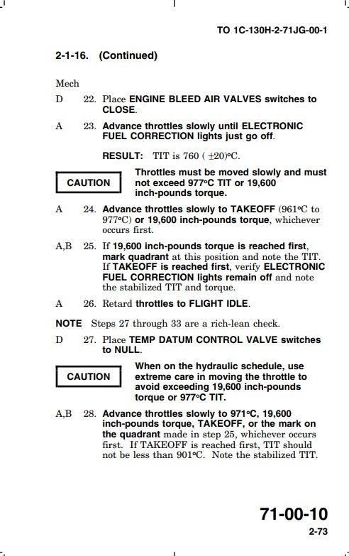

pjvr99 Posted January 24, 2020 Share Posted January 24, 2020 (edited) This is for -7 engine This is for -15 engine Edited January 24, 2020 by pjvr99 Quote Link to comment Share on other sites More sharing options...
