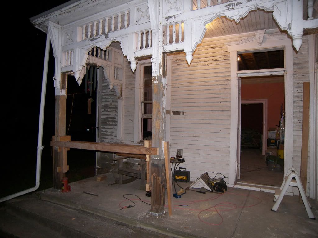

Dan Wilson Posted September 26, 2010 Share Posted September 26, 2010 Well in the last week I have finally got to level out my front porch, and now getting to disassemble all the fancy woodwork for striping and cleaning, and between that I get to shovel out the piles of plaster in my parlor. I am loving this but its really kicking my butt, boy I am really loving those narcotics right now:cool: Quote Link to comment Share on other sites More sharing options...

herkman Posted October 1, 2010 Share Posted October 1, 2010 I take my hat off to you, having walked that way to. Nice to a lovely old house brought back to its former glory. have you thought of soda washing the outside as it will save lots of time but I do not know if over there it is expensive. Do not as Tiny said to use the right headed nails for the correct side of the house. Regards Col Quote Link to comment Share on other sites More sharing options...
hercmech14 Posted October 1, 2010 Share Posted October 1, 2010 Dan...Remodeling house next door for use as a rental unit\ retirement income. I like the way the trim is done below the window. Was there a panel in the frame below the window? Quote Link to comment Share on other sites More sharing options...

Dan Wilson Posted October 2, 2010 Author Share Posted October 2, 2010 Hi Col, soda washing wont be a factor as I am just taking it all down to bare wood, dont take much as most of the exterior paint has already flaked off. I have to pull all the clapboards off to wrap the house. There is nothing between the sheathing and the clapboards so will need to pull it down and put some tyvek sheeting in. The center of the molding under the window was simply lathe and plaster. After it gets re-plastered (the only part I am have to farm out to hired help) I might consider adding something in there besides plain plaster, painted ornamentation or some wood thingymabobs or whatnots. Quote Link to comment Share on other sites More sharing options...
pwylie Posted October 2, 2010 Share Posted October 2, 2010 Hope you're able to salvage that rocking chair on the porch. Quote Link to comment Share on other sites More sharing options...

Dan Wilson Posted October 2, 2010 Author Share Posted October 2, 2010 The rocking chair is fully FMC and is a daily flyer Just need to get another one, the wife is pretty competitive on snagging the chair and leaving me standing LOL Quote Link to comment Share on other sites More sharing options...

tinyclark Posted October 5, 2010 Share Posted October 5, 2010 (edited) The transparent insulation looks good too! Do you have to go with plaster, or can you drywall? Are you too far north to get some day laborers at the Home Depot parking lot? Edited October 5, 2010 by tinyclark Quote Link to comment Share on other sites More sharing options...
Dan Wilson Posted October 15, 2010 Author Share Posted October 15, 2010 Tiny, there is no requirement to plaster but I want to do it for the "original" feel and look. I am not going to put the lath back up though, I will either put up drywall or plywood and have plaster put over that. hell of a lot easier than re-nailing sixty two lebbinty billion bits of lath back on. Have to shovel out another half ton or so of plaster that just got pulled down, back the truck up to the window and start shoveling it all out the window followed closely by some percocet and morphine :) Quote Link to comment Share on other sites More sharing options...
